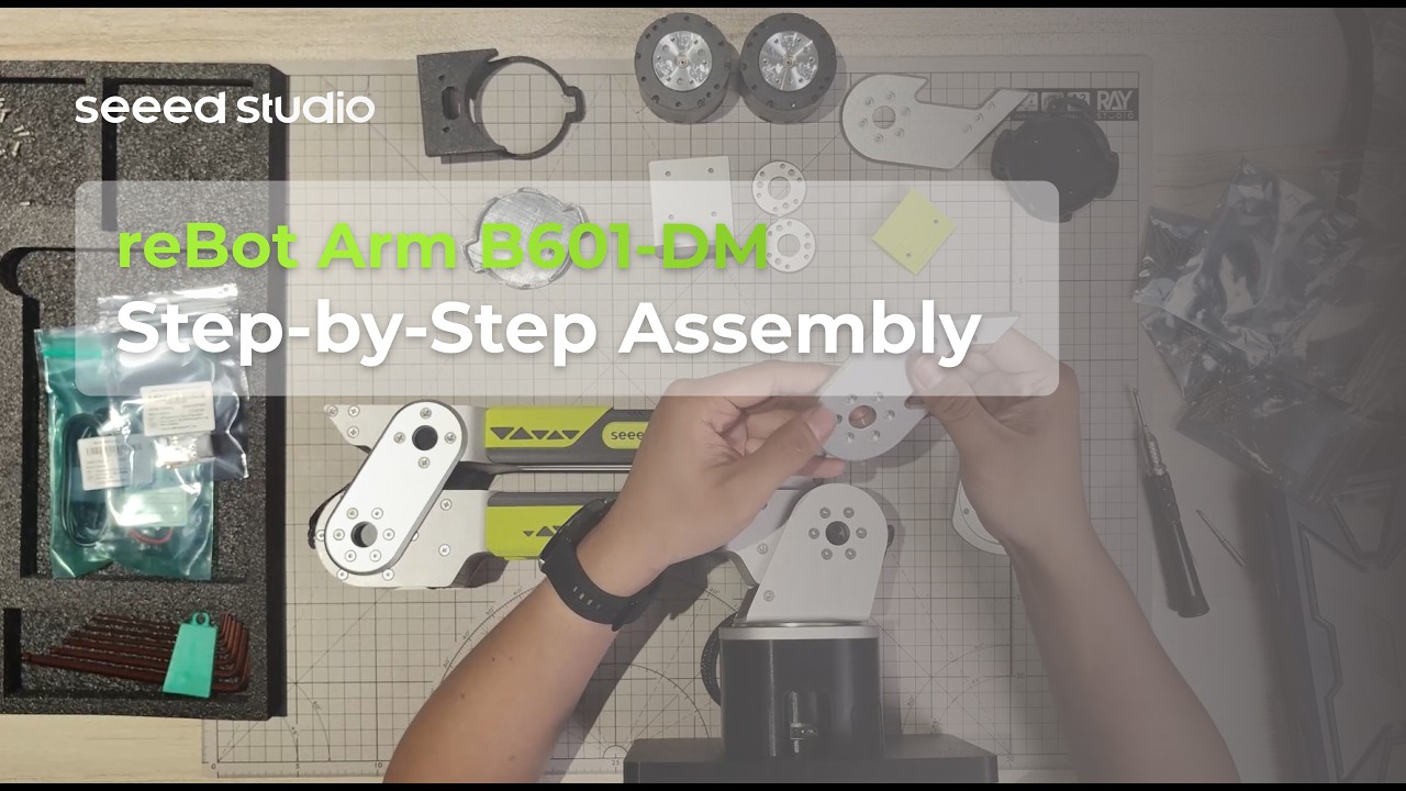

:united_kingdom: Overview
Developer: Seeed Studio
License: Hardware — CERN-OHL-W 2.0 | Software — Apache 2.0
GitHub: 3.9k stars, 384 forks
Status: Active development — fully open source as of May 11, 2026
Seeed Studio transitioned the reBot-DevArm (reBot Arm B601) project from a CC BY-SA NC license to CERN-OHL-W 2.0 on May 11, 2026, making it a fully open-source physical AI development platform. Both hardware and software are now freely available for individual use, research, and commercial applications.
“True Open Source” Philosophy
reBot-DevArm’s defining characteristic is that it extends open source beyond software code alone:
  • :mechanical_arm: Two motor versions: All files open for both RoboStride and Damiao motor variants
  • :hammer_and_wrench: Hardware blueprints: Sheet metal and 3D printed part source files
  • :nut_and_bolt: Bill of Materials (BOM): Detailed down to every screw’s specification and purchase link
  • :laptop: Software and algorithms: Python SDK, ROS 1/2, Isaac Sim, LeRobot, Pinocchio
Technical Specifications
  • Degrees of Freedom: 6+1 DOF (6-axis + gripper)
  • Reach: Up to 650 mm
  • Payload: 1.5 kg and above
  • Repeatability: < 0.2 mm
  • Weight: ~4 kg
  • Power: DC 24V

:open_book: Product page: https://www.seeedstudio.com/reBot-Arm-B601-DM-Bundle.html

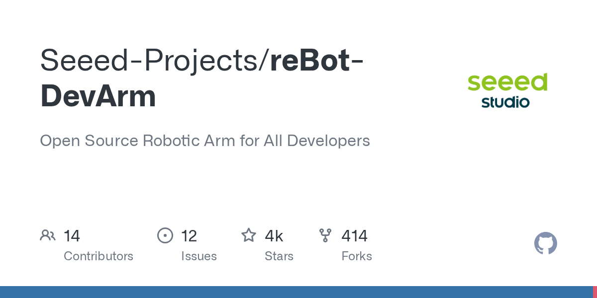

:laptop: GitHub: GitHub - Seeed-Projects/reBot-DevArm: Open Source Robotic Arm for All Developers · GitHub
